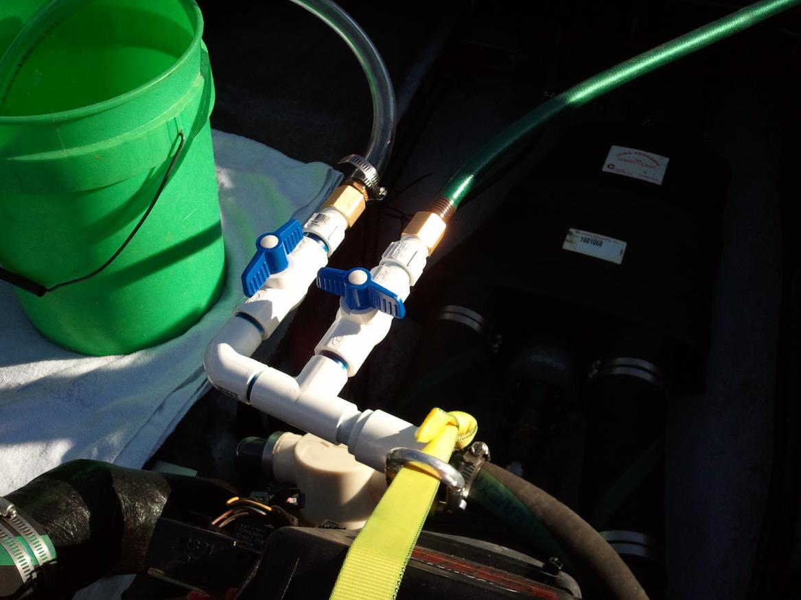

                    I would agree with most everyone here. I didn't go for the 'tee' method though. I like having more control over pressures and what not. This way I can pressure check the system if I need or I can verify that the impeller is working properly by watching it pull water from the bucket. Plus this way all I have to do in the winter is start the boat on water, full the 5 gallon bucket with anti-freeze and then switch over the valves to pull the anti-freeze into the engine instead of the water.
                    In this one you can see that the hose valve it shut off and the bucket valve is turned on, thus forcing the impeller to pull the water from the bucket. It is a nice way to verify everything is working properly.

                    There is a nice safety too, if you leave the bucket valve open and you have too much hose pressure the 'unneeded' water takes the path of least resistance to the bucket. So as long as the bucket valve is open you don't risk over pressurizing the system.
