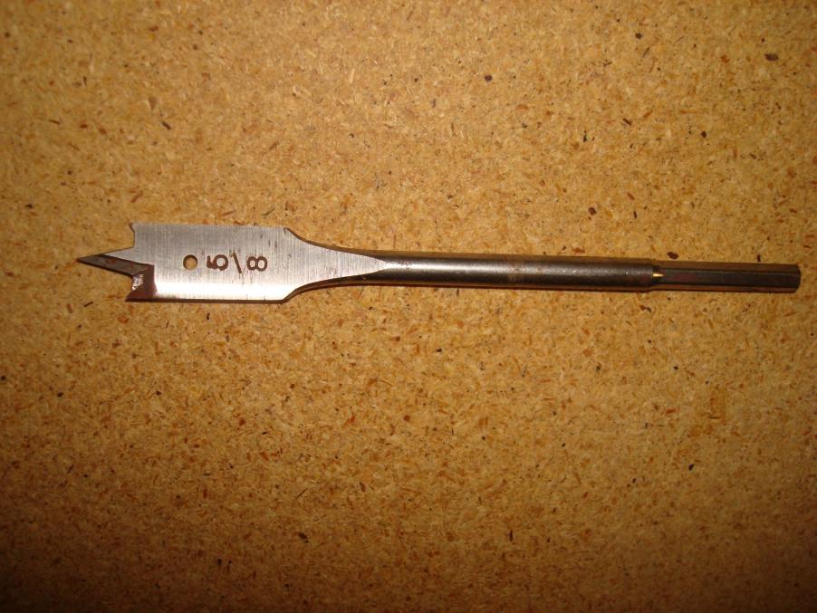

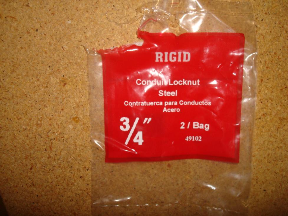

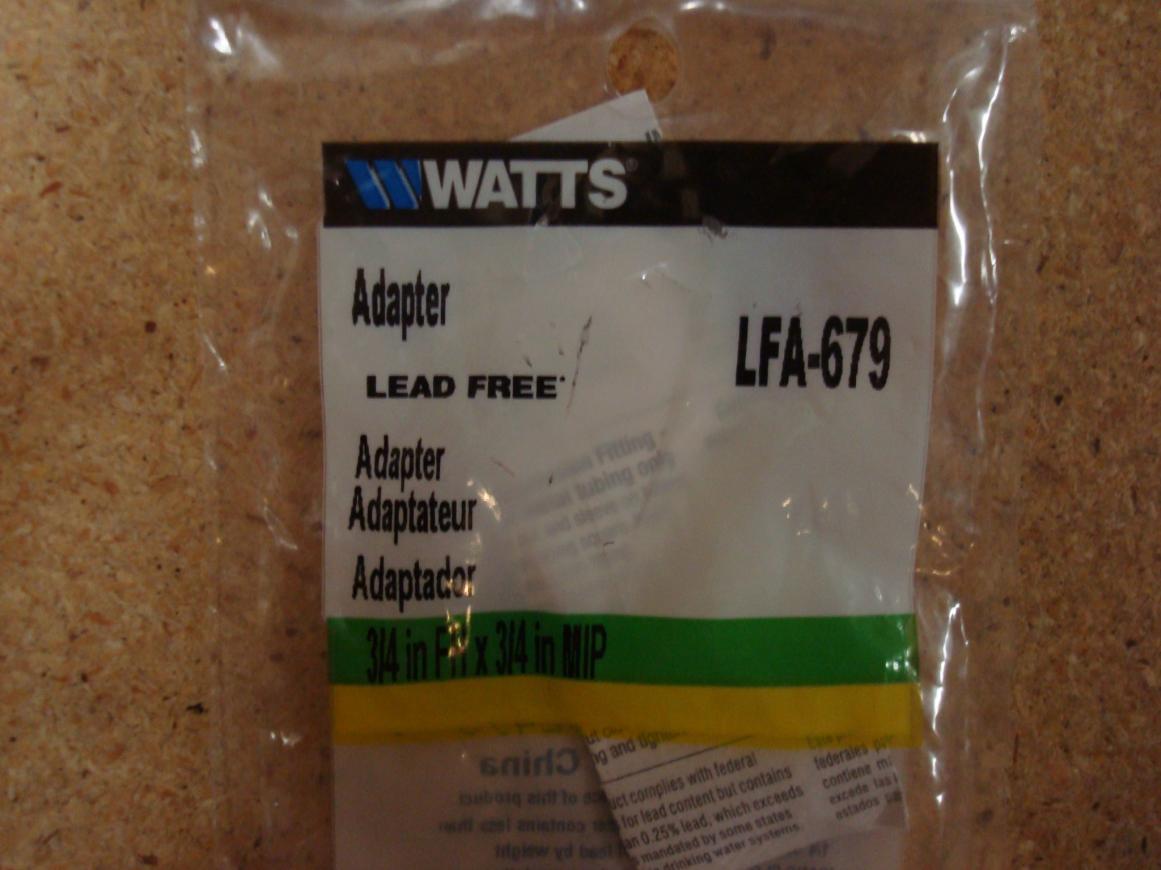

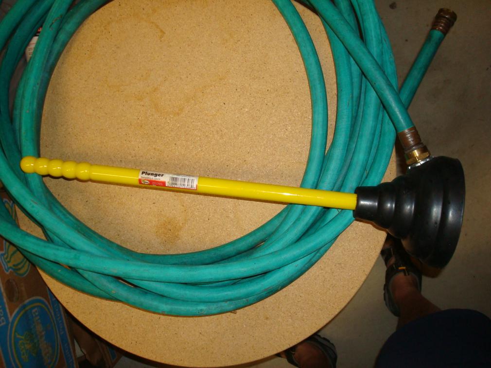

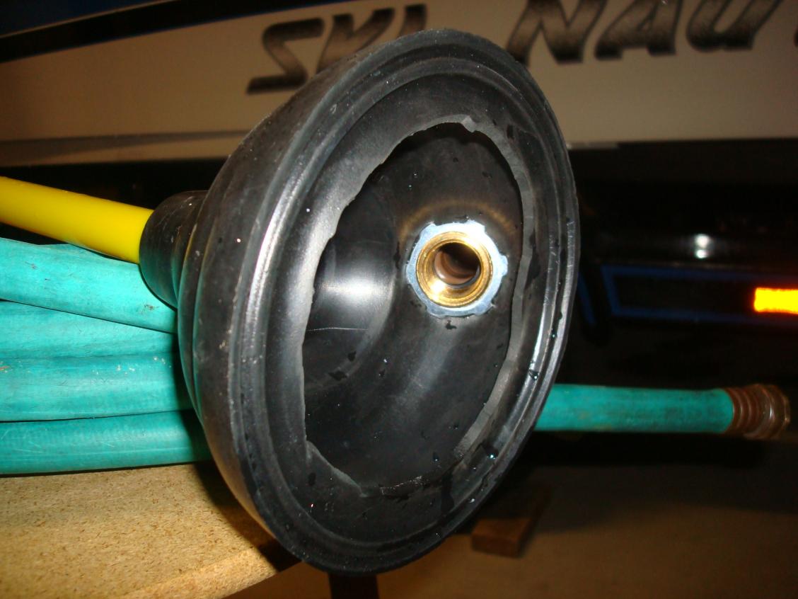

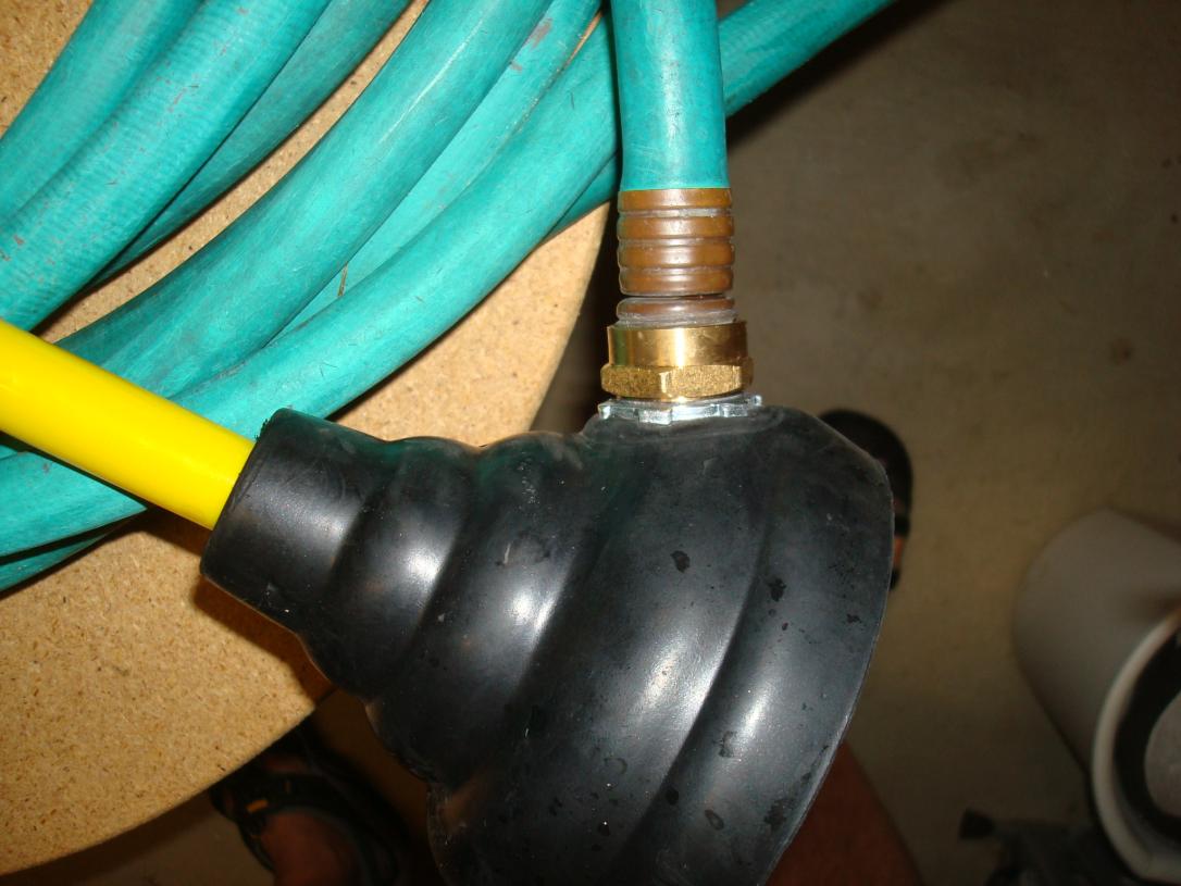

                My inboard mechanic recommended against the pro flush and suggested a fake a lake, his thinking is the less splices and stuff added to the raw water intake path, the less there is to fail; simple is better. I made my own fake a lake with a plunger, a watts 3/4 adaptor LFA-679, a pair of Rigid steel 3/4 conduit locknuts and a 5/8 in hole wood drill bit, all from Lowe's. total cost before my labor $10.62 without tax. I place two pieces of wood beneath the handle of the plunger on the ground and slide the top one inboard to tighten the unit against the hull. I load/unload while warming up or flushing and have never had it move. When it starts to fail I'll just make another one.
