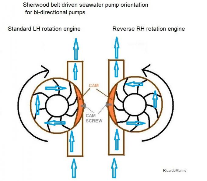

                    Can someone post a photo of their raw water pump on an 89 2001? I need to verify that the pump on my boat is installed correctly. It seems every photo I see the inlet and outlet are closer to the engine but on mine they are on the far side of the engine. The previous owner said he had replaced the impeller but it was all chewed up. So I just want to verify the correct orientation of the pump when it is reinstalled.
                    • gun-driver
                      • Apr 2011
                      • 132
                      • Pittsburgh Pa
                      • 1985 Ski Nautique 2000 Sport Nautique
                      #40
                      Click image for larger version  Name:	Sherwood bi directional seawater pumps.jpg Views:	0 Size:	44.2 KB ID:	651798
                      This should help
