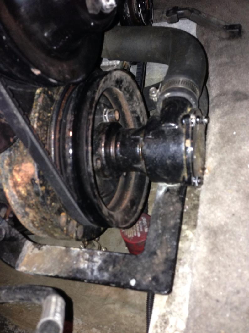

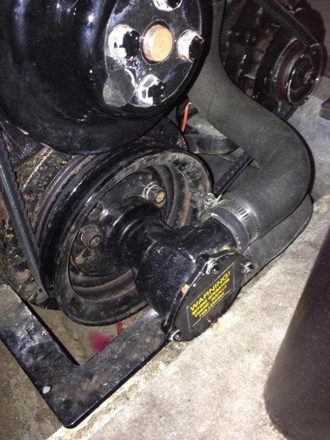

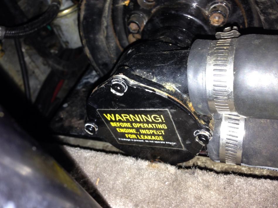

            2000 sn impeller location for water pump
            See the attached pics of where the water pump is on the front of the engine. Would have been nice if there was clearance to pull of the water pump cover easily.

              If that is the raw water pump on a 2000 SN, it is very different than what I have. Ignore all my previous suggestions. They do not apply. Although I certainly see the issue you described, I don't have a good recommendation.

                  GT40 engine does not have a crankshaft driven water pump. You may have the Chev 350 based Apex engine as they run a crank driven pump.

                    Lewey2001: I think the entire pump is simply bolted to the bracket on the bottom that holds the pump and the impeller shaft appears to bolt to the belt pully on the front of the engine. Looks like I will be able to remove the entire pump and then get to the screws for the cover. I'm going to call Zach tomorrow at N3 Boatworks or Bruce down at Nautiques in Orlando.

                      I did mine yesterday, my 2000 SN with a GT40 has the pump on the right side of the engine, that said, remove the two mounting bolts, if you can remove hoses, mine wouldn't come out because of the hardness of the hoses, didn't want to crack or tear hoses, I rotated my pump a little, also the three smaller bolts can be removed thru the pulley with an extension, pulled the pump assembly with impeller out, my key way was loose, be careful not to loose, I cleaned all surfaces really well and installed a new o-ring with some vassoline to hold in place, I zip tied the new impeller to install in pump body, note the direction of rotation, it rotates clockwise, new gasket, some clear silicone, I also installed two of my bolts in the pump to hold the plate straight, don't forget some anti seize on the threads, line up the key way and slide in, tighten three bolts then put back in place and reinstall mounting bolts, good luck
