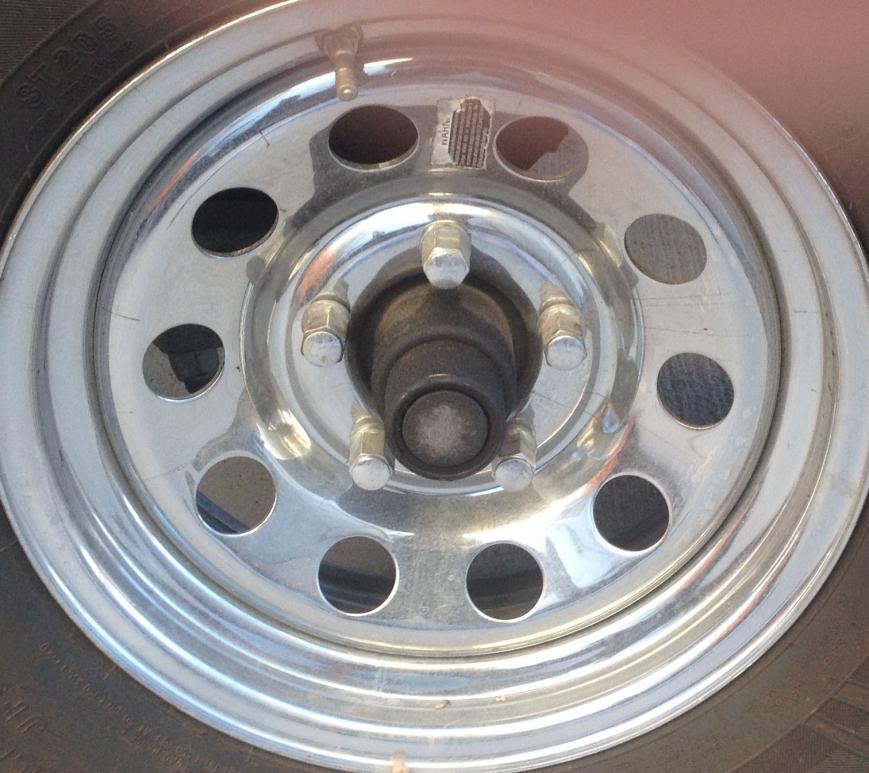

Can anyone identify these hubs so I can figure out how to service them?

Looks to me like a UFP torsion axle hub without brakes (I can see the pinch bolt through the hole in the wheel), a dirty one at that. I have replaced both of mine after they started leaking. Considering the replacements are so reasonable I prefer to just replace them completely versus service.

I would consider that amount of grease splatter pretty normal, just needs a good cleaning...
Those should be pressurized, pop the center cap and it should expose a zerk fitting that allows you to pump some grease in. There is a spring on a floating piston that keeps the grease pressurized so no water can enter the hub. Under normal conditions the center cap should protrude about 1/4" beyond the hub exposing a blue ring. You will probably need to wipe the grease off to expose the blue ring.
Looks exactly like mine, just empty of grease. http://www.ufpnet.com/Portals/0/PDFs...aintenance.pdf They are easy, just sling a little grease on wheels.2005 SV-211

Can anyone recommend some grease that would be compatible with grease it came with? Is green grease OK?
