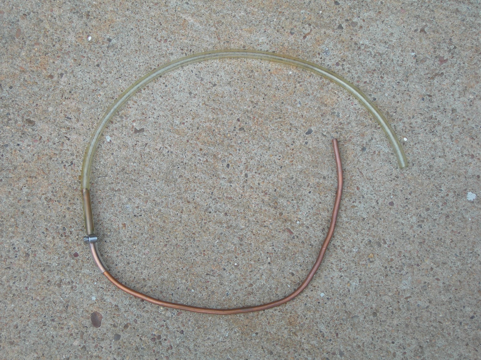

Use a copper tube (instead of nylon or plastic) to insert into the tranny to suck the fluid out. Soft tubes can get hung up and stuck...a major pain and expense.Last edited by xrichard; 05-16-2013, 08:46 AM.Previous boats:

I use a automotive brake line that I got at NAPA and cut to the desired length, attach to rubber fuel line and use vacuum to suck out the trans fluid. The amount I get out is about 1 quart. Refill using a small funnel to the correct level.
I also use the same set-up to remove the 30wt oil from my Walter V drive gearbox. Be careful to completely clean the brake line and fuel line so not to cross contaminate the oil in the gearbox with the Dextron in the transmission...transmission does not like oil and will glaze the clutches.
