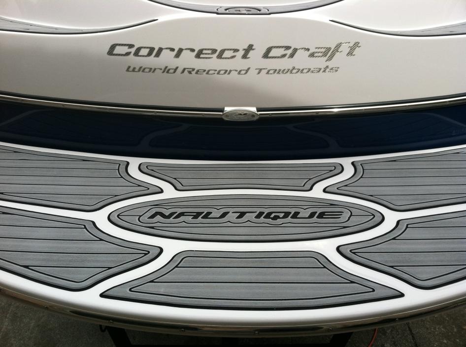

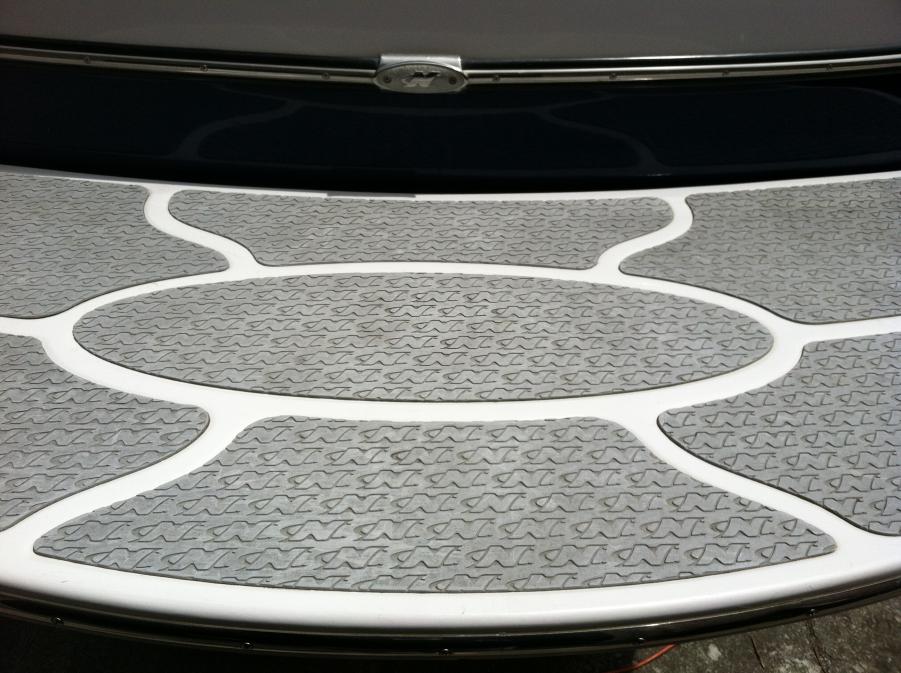

A few weeks ago I replaced the SANO non skid with SeaDek on my 07 220 platform and love it (attached pics). I saw on nautiqueparts they have a kit to replace the carpet for the 220 and am thinking about doing it this winter. My hesitance is what to do about the holes in the floor for the carpet snaps and for the screws securing the center cover. I would remove the carpet snaps before installing the SeaDek but should I fill in the holes, and if so with what? Will I need to cut holes in the SeaDek for the cover screws? Any info is appreciated. Thanks!!
