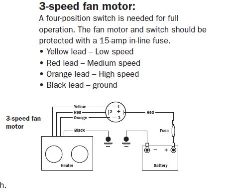

      Would be nice and appreciated if I can get some pointers. I am thinking of wiring the circulation pump and not doing the low idle y. If you have good luck from low idle y please speak up....

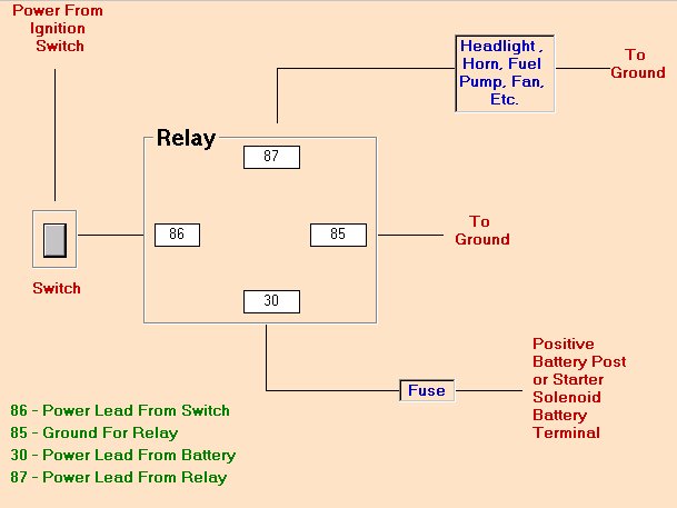

      electricians help please? i get that i as stated in the pic go from battery (battery switch right, really?) to 30. And I also think I get that then 87 goes to pump positive and then pump negative to ground. Got it.
      But now the question is 85 and 86....85 goes to ground. got that. Is it possible to use one relay if I still want to use all 3 speeds? The heater would be hooked up just like the picture, but then when you use the relay you would go from point 1, 2, or 3 to point 86, right? Can I wire all 3 points (1, 2, 3 to point 86 on the relay or with something fry?) Or need 3 relays?
      Or should I just plan on using high only anyways? With circulation pump will i need all 3 settings or will i still be using on high anyways?

        Scott I think u have the relay figured out all right. Again I used 3 relays because I wasn't sure how to isolate the 3 different fan speeds. U will basically be wiring a fan speed(high,med or low) to 86 and the positive of the pump to 87. But I don't see how u can wire all three speeds to 86? To me that would not work as it would likely screw up something. Just use 3 relays one for each fan speed. Everything else can be tied together.

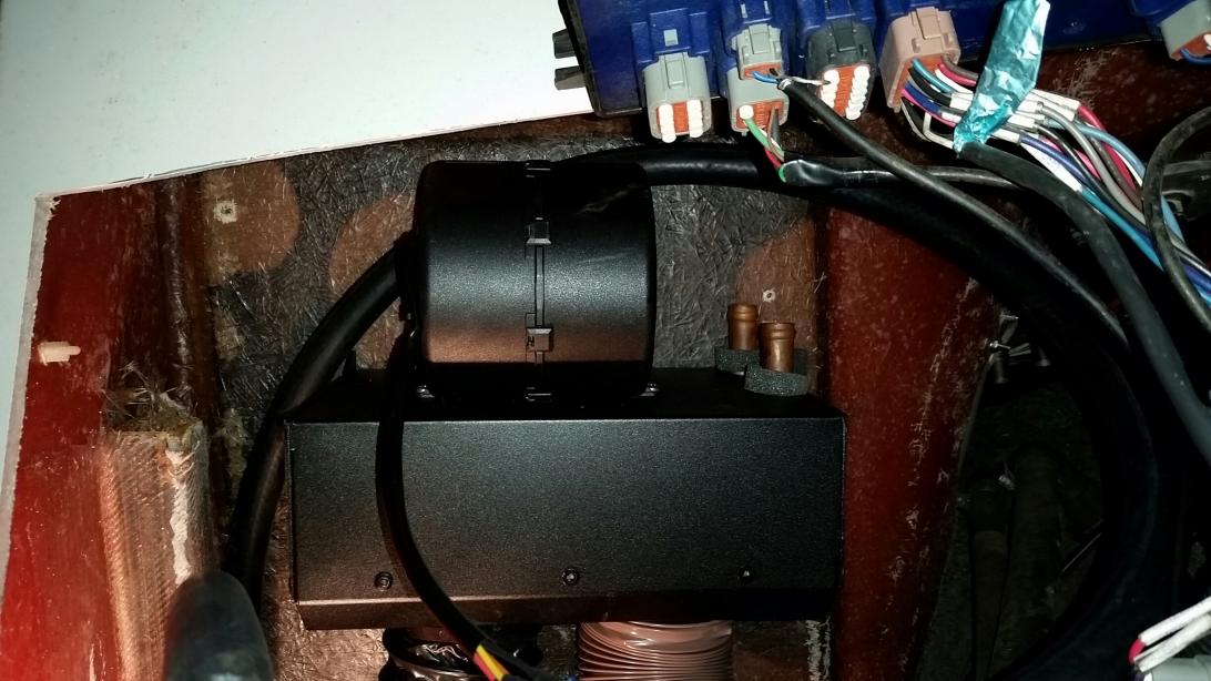

          • 2008 210
          I took mine out for a run for the first time since heater install on Friday and cannot tell the difference in outlet temp from idle to running speeds so I believe the Y is quite effective. The problem I have is I can't get engine temp over 140f. Water was 59f. Wakeboarding speeds with 2500lb on board so the engine was working.

              I just completed and went for water test. I also felt like with the low idle wye the heat was same at idle and cruising at 20 mph. Overall feel good about the project. Probably hardest 2 parts are hanging the heater just because you have to hold it up and screw it in at same time. And running air hose down side of boat.

                  I actually monted it with the fan side up. So the hoses come across the gas tank up under the helm and just curve across and hook on top right. No kinks. Then the air hoses go straight down without having to curve down from the top.
