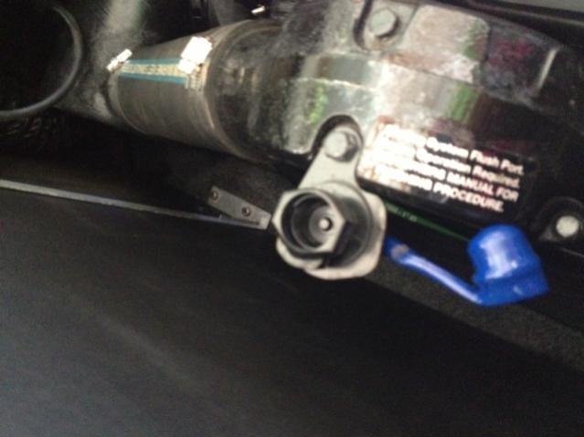

    I am trying to identify the part used on the hose end for my engine flush. Can someone tell me if this is a dealer part is is there a fitting from Home Depot that will work with the boat/ engine connection??Click image for larger version

    Anyone? No help from dealer or Nautique parts regarding the fitting I need?

      I was finally able to identify the connection in original post above. It is a Mercruiser item flush kit Part #898235A01 and the fitting I needed is part #22-857175. The kit ($150) as well as the hose end fitting ($50) is not cheap by any means but is a really cool option if you need a flush option or don't like using a fake-a-lake. I don't use my boat in salt water but do like the idea of being able to warm up the engine to change oil etc.
