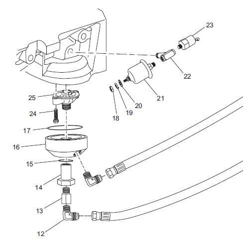

    I have all this info and will post it shortly.
    I need to start getting paid for this.
    Edit: Item 23
    Note: this is becoming more popular than the toggle. I guess I need to order one of these...its inevitable.

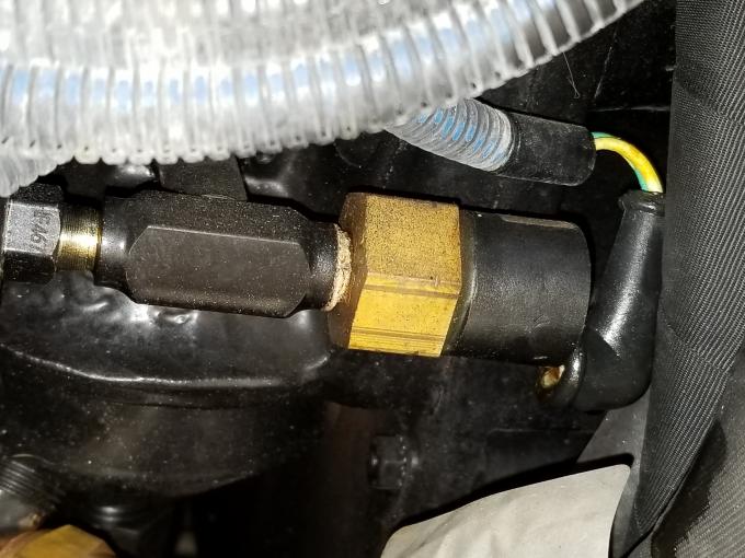

        Update.......replaced sending unit and switch. Was about 30 minute job with the toughest part....getting to it. On my 06 SV211 with 330 Excalibur it is on the Starboard side front of engine near bottom. I had to pull the 2 piece engine divider to get to it......which is what took the most time. Although not easy to get to it...... Very simple to do and save some serious $$. Tested today and problem solved. Oil pressure showing normal ranges. THANK YOU AirTool and Jkallen for your Help!!!!!!

                Umm 21 is the sending unit. 23 is the switch. The switch looks like a mini R2D2 with a flat top.

                    Just replaced mine in my 2008 220 and it was a snap. Disconnected sensor wire and used a 1" Crescent wrench to loosen sender. Very easy to do. Here is link to parts and location.
                    https://issuu.com/pcmengines/docs/l510013-08/22
