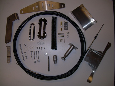

    But you can study the pics in the following thread:
    http://www.planetnautique.com/vb3/sh...-SN-206-please!
    http://www.planetnautique.com/vb3/at...1&d=1366201848
