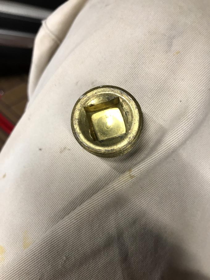

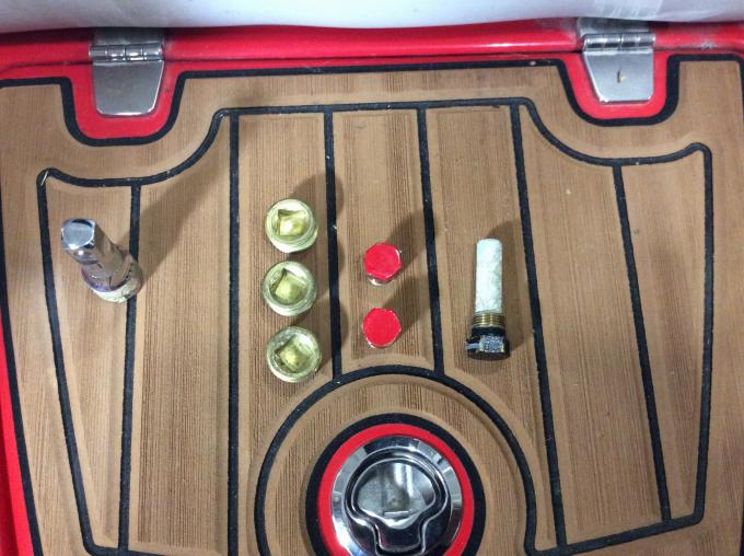

            II'm looking for the plug locations also. I have 3 plugs from where my son winterized the boat last year and can't find where they go. I've downloaded the manual and it doesn't show where the plugs actually go. Any help would be appreciated.

              Oh, the boat is 2014 G21 with ZR409 CES. Might be 2015 I'm not for sure.

                David...look at the above diagram, 2nd post. I tells/shows you where they all go and most of them are pretty obvious. The one you cannot see easily is the one that goes in v-drive (one of the ones that you use socket to remove). I use a wet vac to pull as much water as I can when I drain water to winterize and then re-install the plugs immediately. Course I also fill system with RV anti-freeze cause it helps against corrosion and is another method of insurance against freezing. Keeps you from forgetting where parts go too.

                  Maybe you found it by now...but yep, above is right, look at #4 on the diagram that is where two of the brass looking ones go, and I also re-install after draining....

                    Thanks guys! That did the trick.
