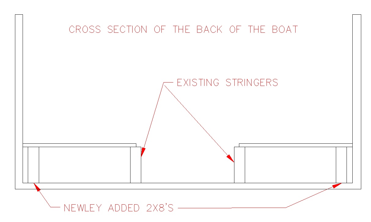

                  foam replacement
                  What else can I use besides foam for structural help?
                  • Mamigacz
                    • Oct 2012
                    • 118
                    • Sheboygan Falls, WI
                    • 1986 Ski Centurion concourse skier
                    I'm sure there are better idea's, but I glassed in 2x8's (wrapped in fiberglass) along the sides of the boat. I did end up using multiple pieces to get close to the contour of the boat sides. This gave compressive support by the stringer and the newly added 2x8's. The 2x8's had to be ripped with a table saw to get the correct floor height. It was very solid, even though the center had nothing supporting it.
