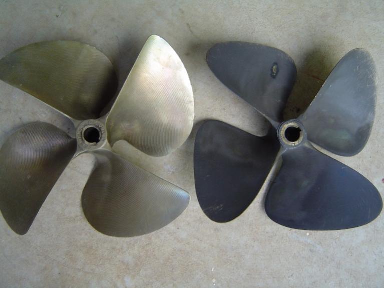

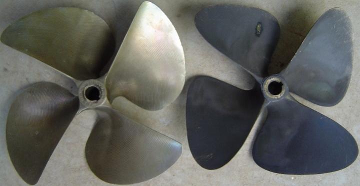

            • Lewy2001
              • 63
              ACME 422 12.5 X 15.5 on the Left and OJ 4 Blade Legend 13 X 16 on the right.
              As Tim states the numbers are somewhat rounded off. The 422 actually looks larger in diameter.

                Thanks for the pictures, advice and help. It sounds like the 422 is the prop of choice for most here.
                If I could drop my RPM from 3500 at 30mph to 3,000 at 30 mph I would consider the prop change a success.
                My engine feels really strong, I am sure it could comfortably pull a better prop.
