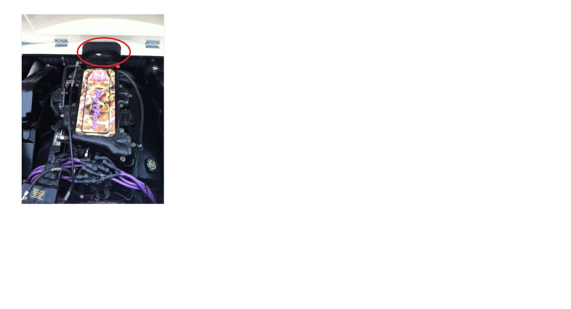

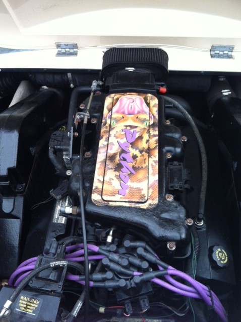

            Sorry guys I think I caused a lot of confusion. Sounds like the 550s actually have a K&N air filter in them. My Python has a metal mesh spark arrestor that is made by K&N. I am talking about what is circled in the picture on my boat. I agree with Core-Rider that you should NOT use the methods I described to clean a traditional K&N filter but for a spark arrestor I think it is fine and has worked for me without issue.
