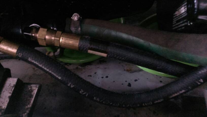

                                Noticed this hose was damp with Dex this morning. Is it supposed to be this way? When I wipe with a paper towel on the tranny, it get a little pink on the towel, when I wipe where the hose attaches to the pump???, I get the same remnants. Picture is where it attaches to the pump. I am not much of an engine guy(trying to learn). Thanks fir the help. I am also putting a wrench on all the bolts, but this appears to be the source. Click image for larger version
