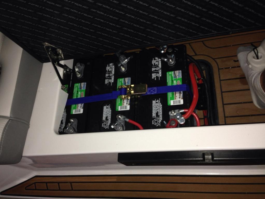

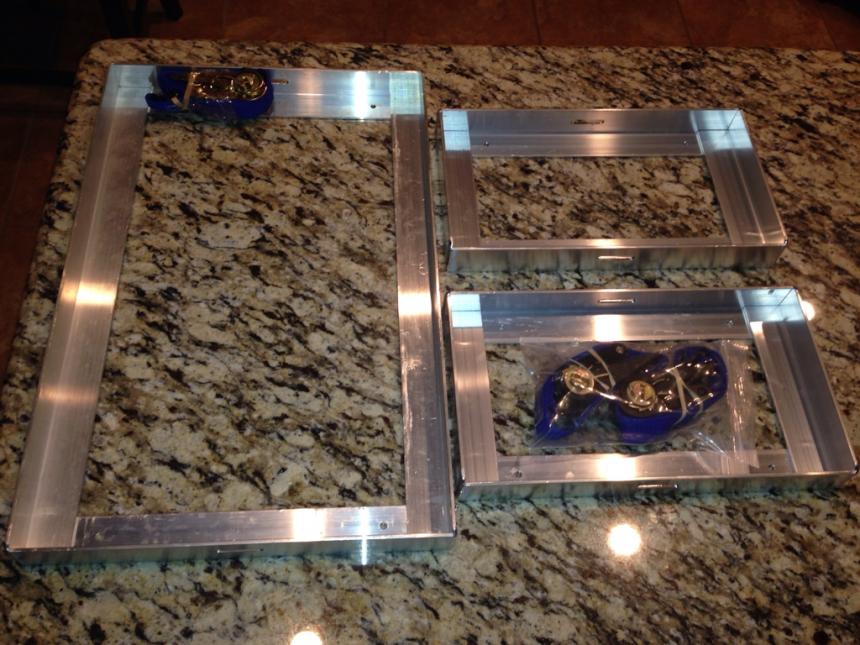

    I've had a pure hate / disgust relationship with just about all the marine battery mounts and boxes I've seen. I don't think they do their job well...... Till I saw RMC Boatworks and their aluminum trays with ratchet straps. These mounts will outlive all of us trough a nuclear war

      They look nice. How did you attach them? Just screw them down into the floor?

        yep, four 1" stainless screws down into the floor. Ensure you know what you are drilling into... it'd ruin your day to drill into the gas tank, ballast or wiring.
        In my case, I had to trim approx 1/8" off the screws with heavy lineman's pliers so that the factory ballast bag under that floor would not get punctured. Drilled a tiny pilot hole into the floor about 1/3rd of the screw width prior.
