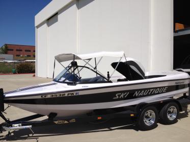

    1999 Ski Nautique PCM 351 won't start
    Replaced plugs, Cap, Rotor, Coil.
    Ran great today for +3 hours.
    Only 2 times did engine have trouble starting
    Finished skiing and idled into Marina. About 100' from ramp engine dies and will not restart
    What's the possible problem?
    thanks

                              Out of curiosity what engine do you have? I thought the 351 1999s were the EFI GT40. I knew about the 302 but haven't seen anything with anything other than the 302 or GT40 for sale. Picture would be awesome if you have time.
                              Sent from my RM-877_nam_att_205 using Tapatalk
