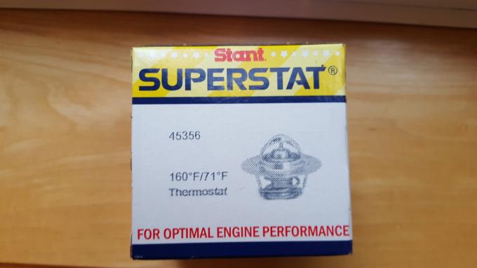

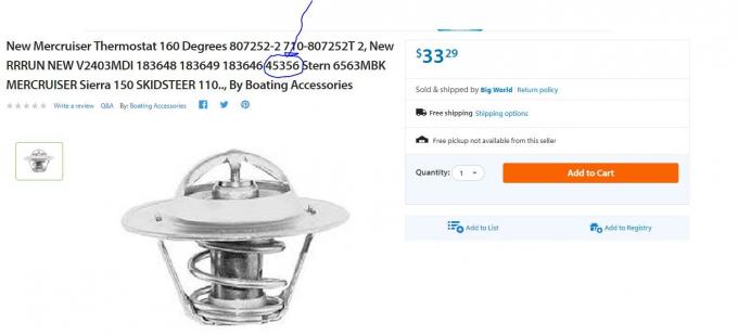

              The thermostat is not special. I had to replace mine a while back. I replaced with this one and fit and worked fine. You can pay $30 or $40 or pay $7 bucks up to you!!
              Click image for larger version  Name:	thermostat.jpg Views:	1 Size:	23.5 KB ID:	535494
              Click image for larger version  Name:	Capture.JPG Views:	1 Size:	22.0 KB ID:	535496
