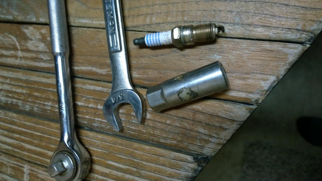

      I believe it is a 5/8". Use the socket as shown in the picture. If you're real tight you can use the 3/4" wrench on the socket instead of attaching the socket wrench. You might also be able to use a 5/8" box end wrench.

        Thanks for the great advice! jhersey29, I need to get me a spark plug socket like the one you pictured! That would definitely give me more options!
