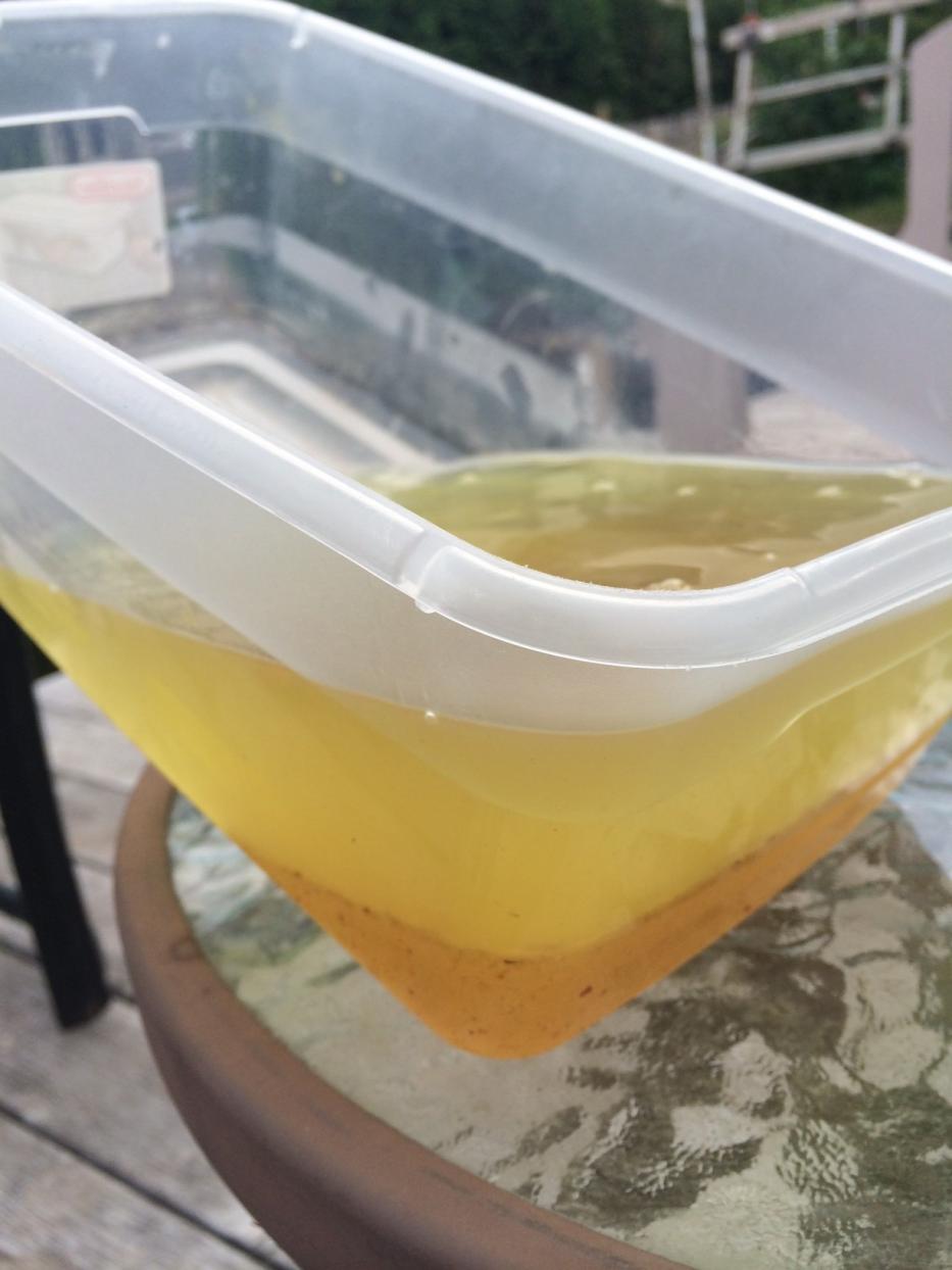

                So I have some updates for you. I went out on saturday to trouble shoot everything and went to drain the fuel cell. Unfortunately I satripped the drain nut underneath the fcc. Why would they use a brass nut anyways? As a result i had to take the whole fuel cell off and drain it from where the gas goes into the Fuel cell.
                I added a whole nunch of fuel stabilizer and super grade gas. I basically went out and came back in went out and came back in draining the FCC each time. I did this a total of 4 times. (You may see what I had in the GAS tank below). Apart from water there was tons of Junk in there.
                The boat is still running a tiny bit rough but each time it gets better and better.
                That being said i wanted to send you guys a conclusion that water in Gas
                1) Makes the engine run rough spuratically, at idle its more smooth
                2) Slight back fires
                3) Boat doesn't plane usually
                The different is that had it been electrical i feel the misfires would have been more consistent and all the time
                I need to admit that I think i may be the culprit of the water in the Gas. I had 10 people in my boat and 4 fat sacs loaded right down. Water was literaly coming in the side of the boat. Do you guys think it is possible that water go down the gas take breather hole?

                  Water can for sure make it's way into the gas tank from the vent. We have to appoint someone in charge of covering the vent when we surf on the port side.
