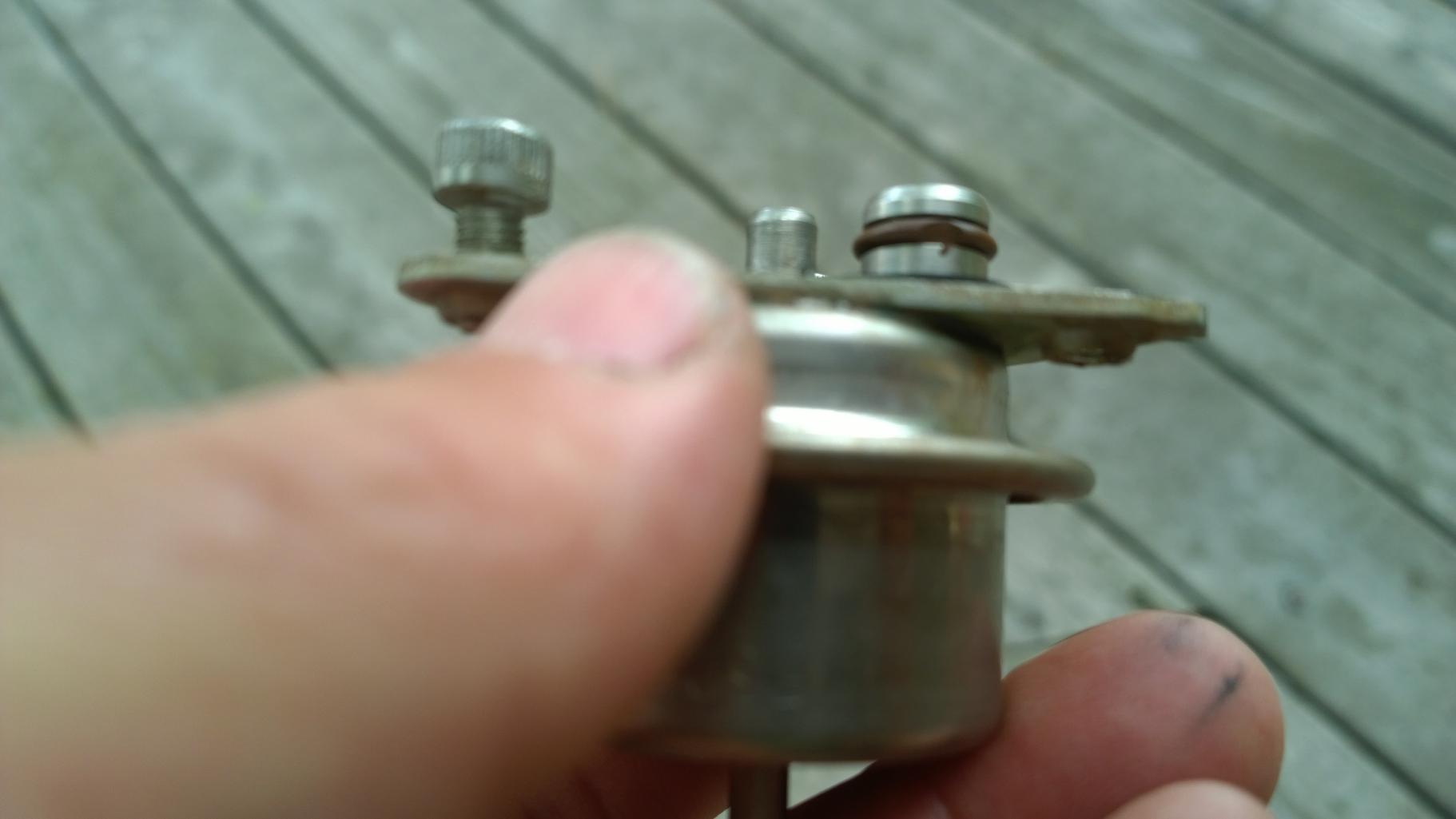

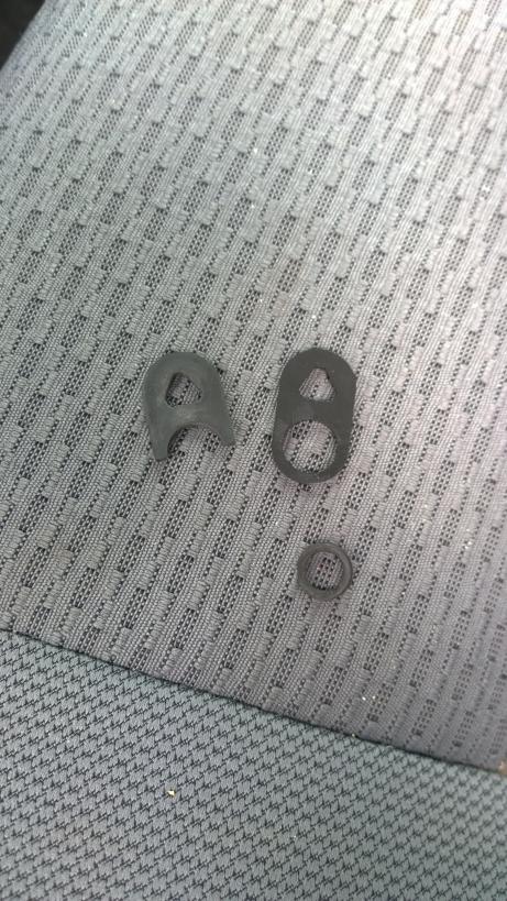

    I wanted to share the crazy experience I had with my 99 Ski Nautique GT-40. I've been having a intermittent hard starting issue since I bought the boat. I've been replacing the inexpensive parts(relays, fuel filter, plugs, cap, rotor, etc.) that I felt comfortable replacing since the were old and needed some love and also have been reported as known areas to address. I finally think I've narrowed down the problem to the fuel pressure regulator using a leak down test. I ordered a new one for $170.00 from a dealer online. The new one arrived and I put it on last night. It's pretty easy but smaller hands would be nice. Only 3 Allen bolts to deal with. I went to test it on the water and it is leaking like crazy. Gas is spraying out all over from under the regulator. At the lake I took it off and found 2 things strange. The new rubber gasket did not go all the way around one of the inputs/outputs and the o-ring was bad. Brand new and BAD! I think they are 14 years old based on the new box and probably dry rotted even thought new old stock. Good thing I never left the doc and made sure to check for leaks. Blowing myself up would not make for a good week. The boat started right up even with it spraying fuel all over the place. So I went to Napa and found another regulator for a Crown Victoria that looked identical and has the full washer and a new o-ring. It was only $31.65. I put the washer and o-ring on the regulator from the dealership since I am not sure the Napa one at a fraction of the price is the same as marine grade(thinking I over paid by quite a bit but not sure). I put it back together and no leaks and all seems good. So did I get burnt on the regulator from the dealer or is it actually maybe a stainless steel casing or something special? It just came in a Motorcraft box so seems it was OEM Ford. Also a warning to anyone replacing these! Make sure the new parts actually have good rubber washers and o-rings and look for leaks. Attached are pictures showing the new rubber washer from Napa on the right, New bad one from the boat dealership on the left, new bad o-ring from the boat dealership part. Also attached is a picture of my old regulator and it's bad o-ring.

        In my leak down test I was loosing about 5 psi nearly instantly. It would go from 40ish to 35. Then a slow steady drop from there. With the new regulator, rubber washer and o-ring. I get a solid 39 psi and it takes about 15 minutes to drop the pressure to 38 psi. I have also gained 1.5 mph on boat top end. In Denver the boat was topped at 40 mph. She got up to 41.5-41.8 after the fix.
