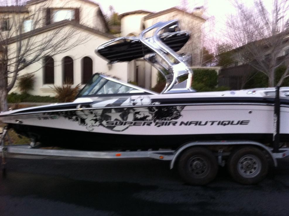

    6 months ago I bought our first nautIque 210. Year 2009. It has the 409 engine in it. It has been an awesome boat. But I want to do a little maintenance on it. I want to change the impeller. Can someone tell me where it is located on the motor?

      Follow the inlet hose from the thru hull fitting to the raw water pump. It should be located on the starboard side first pulley you come to, about the same height as your exhaust manifold.

        Thanks I found it. I did not see the tabs with the manuals.
