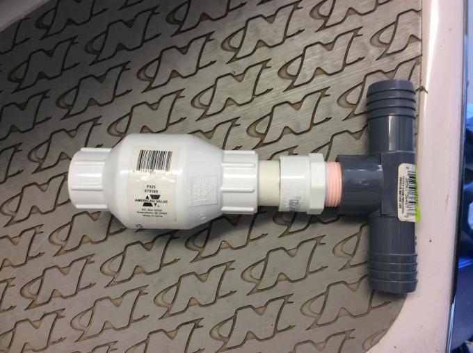

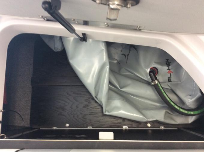

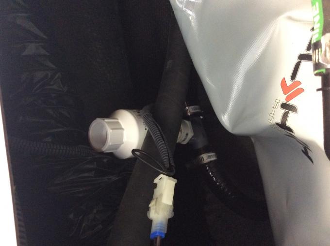

                          Here is the solution that I finally came up with. I made tables out of 3/4" marine plywood and galvanized angle to lay the rear bags on. I always thought it was a little sketchy to place 400 lbs on top of a plastic tank. Then to prevent a vacuum collapse I put a T in between the main tank and bag with a check valve. About $10 from Lowes.

                            What is the purpose/end result of the T check valve?
