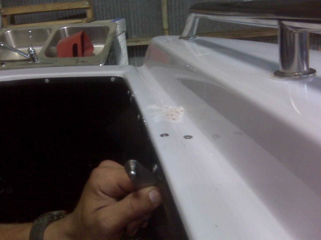

              Would it be possble to attach the springs to the outside? Like this?

                Probably, but you'd have to get a different type of bracket. And if you mount it to the fiberglass only, you might put undue pressure on the gel that may cause cracking. But a bracket like this (only turned sideways) should work if you want to go that route:

                  Thats really helpful scarbs thanks. I think i will try it on the outside and if it doesnt work ill just try to support the middle.
