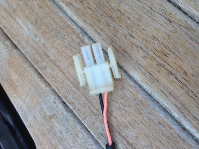

                      thats a good idea. I just gotta find the pins. Here's the pic of the male end i need to replace. I've got to order something else from NautiqueParts, so i was hoping to kill two birds and get the connector from them.
                      • beach
                        • Jul 2010
                        • 245
                        • Alabama
                        • 2003 SAN 210
                        I meant that you could cut the wires 2 inches behind the old connector and crimp the connector on to your new sender. That way you wouldn't need to order anything except some marine grade butt connectors.
                        http://www.amazon.com/gp/aw/d/B000S2...=SS115&simLd=1
                        Or you could see if nautique parts has the connector/pins.
                        • hpdixon3
                          • Dec 2014
                          • 44
                          • USA
                          ohhhhhhh. I gotcha. Great idea. Thanks bud
