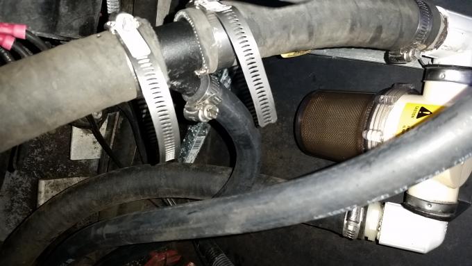

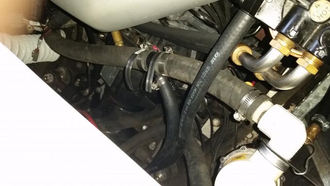

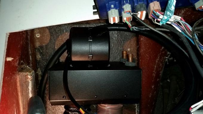

          Here are some of my pics and stuff. So I used the water out and the wye so not the water return. Also notice that I mounted the unit with the air hoses direct down so the water hoses came around from the left and over, but then the air hoses don't have a bend. I thought I would get a bit better air flow.

            Another idea I implemented was an inline strainer. I found the holes corse mesh in the main strainer allowed for small debris to block the tiny hole in the low idle wye. This is what I used and it has a fine mesh filter. It may also prevent anything getting stuck in the core itself. Certainly peace of mind for $10.

                I that core mounted to the back of the front seat area?

                    Honestly you should not worry about me and my ability to complete a heater install. I am not concerned the least bit about it. I have had the panel off numerous times and was trying to relate to how you oriented the core/ blower based on the photo you provided. I do take into consideration the numerous ways (just like the way you asked about the shut off valves etc.) that folks have taken with their installs such as yours and aZ. In any event thanks for the concern and photos.

                            Scottb7 did you mount the heater unit up side down in the boat?
