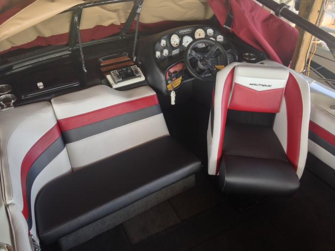

    Has anyone tried to adapt a swivel to their late 90's Nautique driver's seat? I'm thinking it would be nice to be able to swivel the seat when we are at rest.

    I did it on my 91 Barefoot... It's pretty easy really. I just had to drill new holes in the base to slightly offset the seat so it can swivel. There is limited room in my boat so to get it to swivel all the way around I have to slide it up, then swivel, so that it clears the shift/throttle lever. (Probably not a recommended CC procedure because I am sure someone not thinking or being ridiculous would try to swivel it underway and bump the throttle). But NP I think has them on clearance.
