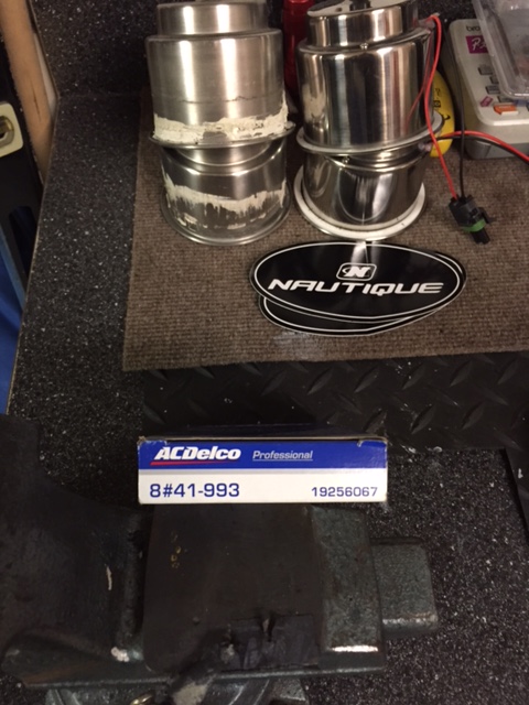

                I bought the plugs 41-993 and the threads are longer than the ones in there. Did you confirm the 41-993 is correct?

                  Yes. Here is a photo of the box. I can't comment about the Autolite as I tried to cross reference them to the AC Delco 41-993 and it does not match. If you look on the Skidim website they reference the AC Delco 41-993 as the correct plug but is superseeded by 41-101

                    Ok. Then I should be fine. I think the previous owner had the wrong plugs. Just generic 5.7 L.
                    Thanks again for confirming!
