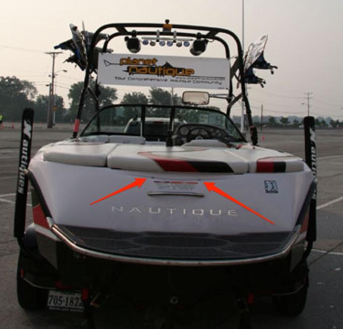

There are releases for each side on the back too. That's how you can open those compartments from the platform. Try those. That'll tell you if the switch is bad or if there are other issues.
Here's a shot from my '03.
Didn't they slightly change the transom from 02-03? I'm thinking the 02 models didn't have the rear buttons because the transom was shaped like 01 and doesn't have that the same ledge where the switches are. Could be wrong though.
