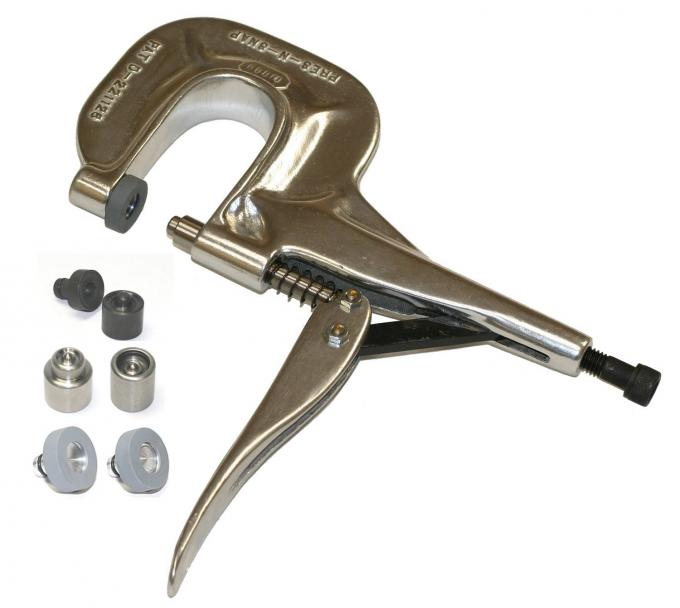

    Are these the typical domed, chrome (on the exterior of cover) and have the female snap (with steel ring inserted in)? These are standard marine types, You can get a package of these at hardware store, includes the die and swedge tool that you smack with a hammer to install.

ID:	465814 It sucks if you only have to do one, but.... there is a "proper" tool... called the "hoover pres-n-snap" tool. I bought one a few weeks ago to put the snaps in the new ski locker carpet. I ended up finding it on 4th of july sale for just over $120 shipped. (ouch...)
      I have never had luck with the bottom form and post you try to hammer the rivet end over with, as pictured above.
      You might be able to just call a local canvas shop, I am sure for $10 they will put a snap in there for you and you will save ordering them online and the frustration of trying to get one to hold correctly.
