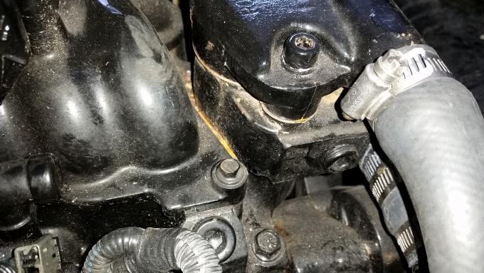

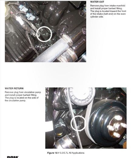

    You probably need to download the engine manual for your own. But here was mine. So it will look something like this. If you are using the low idle wye, which i highly recommend you wont use the return in the pic.

      Hi Scottb7 yep i have put the return thru the low idle wye thing but in your first pic where the plug is i have a temp sender there .the motor is a gt 40

        Can i tap into the tthermostat housing plug ? oh better check if my one has one of those.....

          and would the water still be as hot?

            When I spoke to heatercraft they also recommend the side of the block and to make a t with the knock sensor. You can see what you have there.
