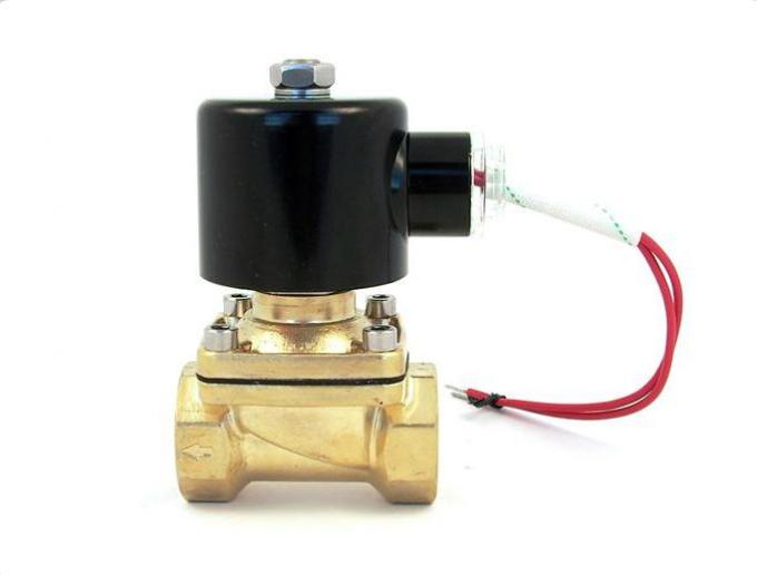

              as pointed out above there are several ways to skin that cat. but the specific issue of opening and closing valves can be remedied by installing solenoid valves like these in line. they open when you power up your fill pump, problem solved.
              there are several threads on here that discuss this in detail, btw.

                I actually have that solenoid above in use in my boat already! It works great for what it's doing - closes the empty port for the rear ballast while filling because they would drain while I was filling (I have bags tied into the stock system). But I don't think I'd place those in the hull. Mine are already rusting on the top and if you got any water in the hill you'd probably be screwed! I think the red hats are the way to go still. Just really pricy
                  been using those valves for years with no trouble. are the red hats supposed to be better or something?? they look like the very same valve, lol
                    I think they're water proof? Jeff might be able to chime in. My concern with the ones you listed is that if I take on enough water for some reason to emerge those solenoids under water, if they will still work. Have you done this? If that's the case I just might repurpose mine!
                      i don't believe iv'e ever had enough water in my bilge to submerge the coil on top of the valve. the coil enclosure looks to be at the very least water resistant if not water proof. i guess if it happened and hosed them up permanently, i'm not out much at $30 each. but again, i have yet to have that happen.

                        I have been using solenoid valves as well. They work great and I never have to deal with the plastic valves again.

                          Just bought 3 of them. Going to buy some 3 and 4 inch shrink wrap to make them relatively water tight just to be safe.
