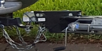

      Post a photo with the trailer tongue so we have a better idea of what brand/ model of system it is. If you are pushing it you are engaging the brakes......if it is a UFP you can stick a nickel in the slides closest to the ball and it will not let the tongue slide to activate the brakes.

        Pushing it from the front so I don't have a power connector. Paxdad, u have it right. Had to go back to work so I'll try and get a picture in the next few hours. What's ufp? Anyone know what's common on a 2000 dorsey?

          Only two I have right now .

            UFP Surge Brakes... http://www.ufpnet.com/actuators/tabid/54/default.aspx

              Here's a video showing what he's talking about with the nickel... http://www.ufpnet.com/movies/UFP_A-60-Lockout.mpg

                The nickel is placed in the slot on the side of the tongue with the big round pin in it. You may have to put a piece of tape over the nickel to keep it from falling out. The video provided by Tmosely1 shows exactly what to do only using a nickel.
