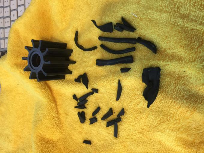

                Well, I started the process and got as far as the right side of the exchanger. Take a look at this pic. I put a new one next to the old one just to use as a reference. Do you think I should keep going? It looks to be a pretty healthy project to take the exchanger completely out of the boat. On the side of the exchanger there are 4 different ports. All of these pieces were lodged in one of the ports. No doubt this contributed to my overheating at higher speeds. Once again, I really appreciate all the input from everyone.
                SSTEXAN

                  Wow, that looks like it would be the most of it for sure...mine only had small peices, no lArge chunks like that

                    At least take the end caps off and shine a light through the exchanger tubes
