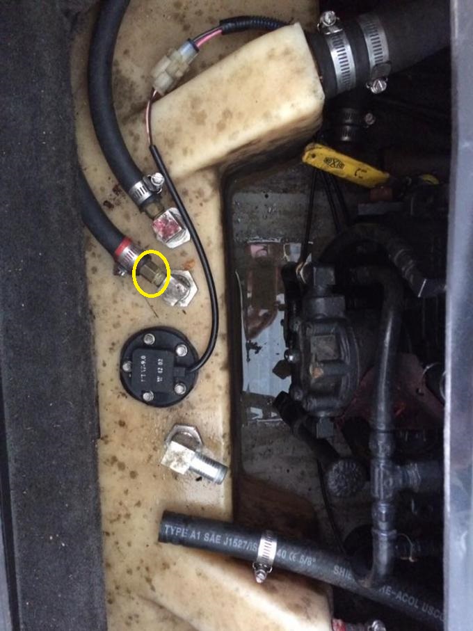

      Yep, that's the breaker.
      Anti-Siphon valve:
