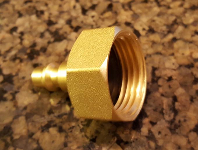

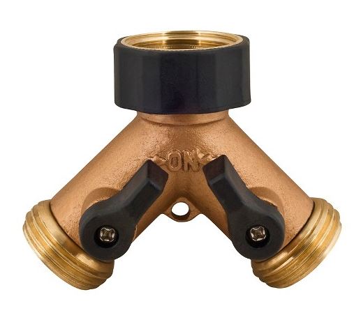

            Yeah, I added ability to shut off my system a week or two ago... All you gotta do is go get 2 male and 2 female 5/8 barbed hose connectors. Cut the lines and put them in nearby engine compartment where you can reach...5/8 inch lines just like hoses. So simply cut each line put in male on one side, female on the other of each hose where you cut it. So you connect them when system is being used. Then if you have to shut off you disconnect. And use simple hose splitter with each side of splitter (black shut off) in closed position for shut off. (So at top of the y just is not used when using the thing to shut off the system. Just handy to use since it has 2 male ends each with a shut off).
            So the side that has the engine put the female hose connector. And put male side of each hose connector on the heater core side. Then you can use the last item pictured to blow out the system since you will have male side of connected on the heater side.

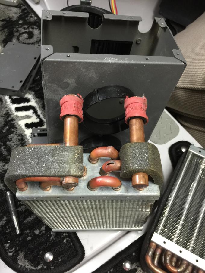

                  This is likely what happened to your core. Mine busted over last year's winter and I just ordered a new replacement. Around $120 I thinkClick image for larger version

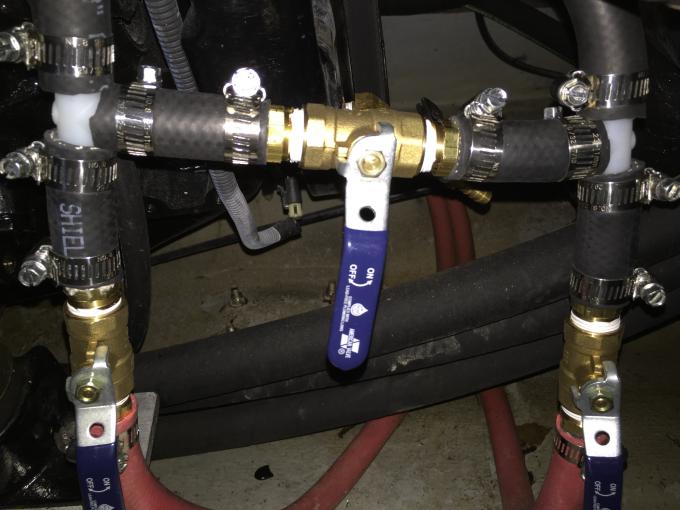

                    This is my version of a bypass valve that I added to the heater lines Click image for larger version
