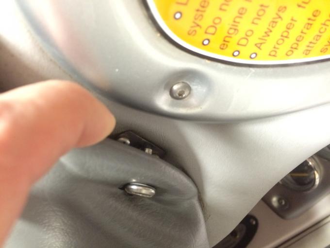

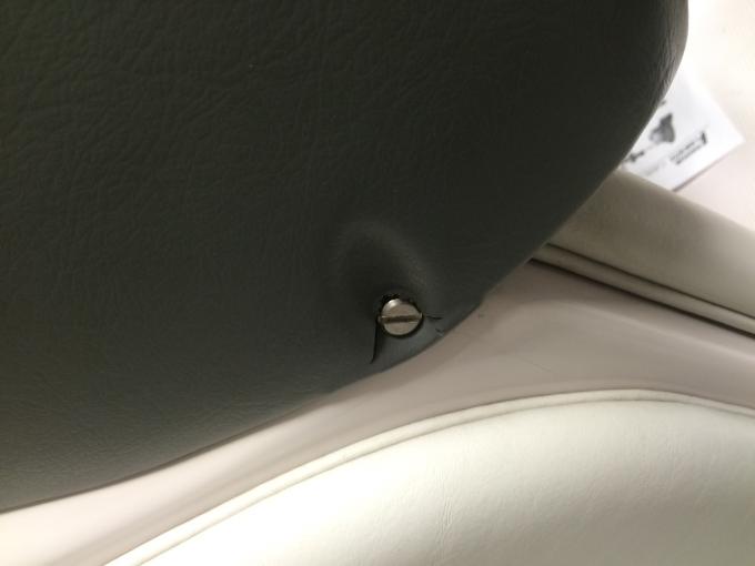

    Has anyone experienced the way the dash pod vinyl kind of breaks and/or tears like this? I can't quite get the bottom right screw to line up with its hole either. If anyone has fixed these issues I'd be happy to know what you did. thanks!

    I haven't had a hole alignment problem but, I have had a problem with the vinyl ripping. I found a stainless steel washer that I put under the screw head so, that there was more surface area holding the dash down.
