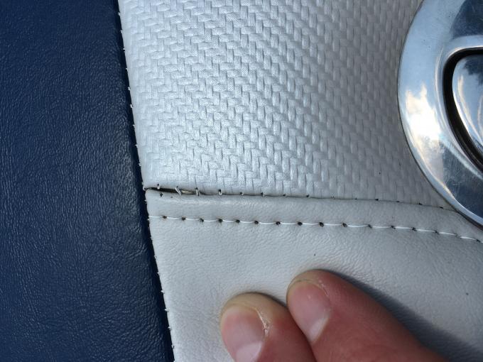

Hey guys I have a couple seams on my sun pad where the stitching is starting to pull through. Can this be repaired or will I have to get new skins? Is there a way to keep this from spreading?
You might e able to re-stitch that from the top with a hooked needle, I found a couple of videos on Youtube that show how to. Aside from fixing it from the top side, you'd have to pull the skin off to stitch if from the underside.
You can stitch that without removing the skins. Check out stitch leather repair on youtube. The seam wont look as factory as removing the skins and stitch from behind, but it will look nice and stop the seam from opening.
