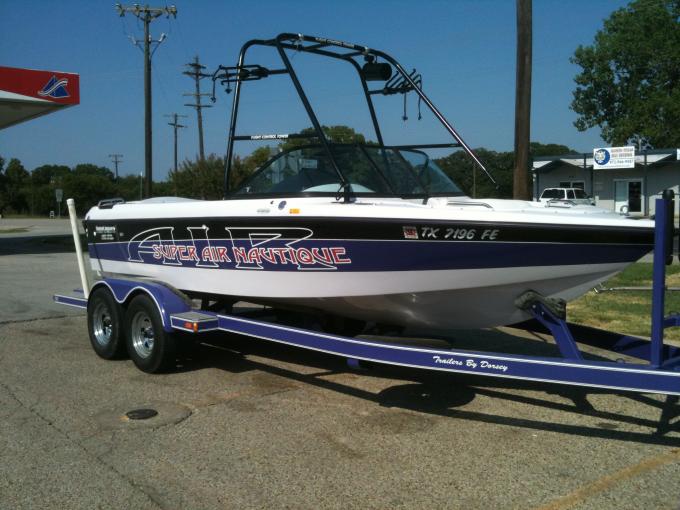

            Here is a picture of the 1999 SAN w/ Python motor, center ballast plumed, updated gps perfect pass, and new stereo system.

              That's just awesome.
