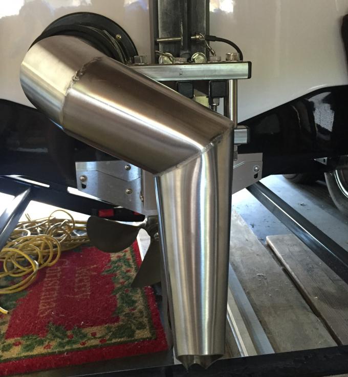

                Has anyone with a FAE pipe installed on their 210 experienced any spray or wave affected by the pipe at all like max has experienced?

                      I did correct mine and went narrower at the bottom. I'm at 2.25in right now. Very little spray but now turning 200-300 rpm more for the same surf setting.
                      Are any of you experiencing a change in rpm? It make sense to me since there is something dragging into water right now.
ID:	495334 didn't notice any change in RPM or spray only quieter and no fumes when surfing.
