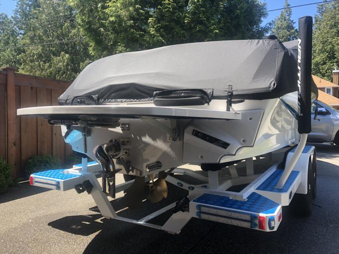

                  #23

                      Originally posted by Randy1833
                      AWESOME! Looks great! Glad I could help and thanks for posting sizes cause thats one thing i did not keep up with....enjoy!

                        #26
                        All done, OEM laddder and OEM lights.
