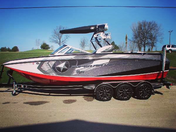

    I am writing this to see what others have done here. I recently purchased my 2013 SAN G-25 and the first thing that I went to have done is to have the windows tinted. However, I have taken it to three custom tint shops only to be told by each of them that the extreme bend in the front two windows on either side can not be tinted. I have been through multiple shops and ever multiple tint guys at each shop and they have all told me the same thing. I need help. I live in Covington, Ga (30 Miles East of Atlanta) and I don't know who else to call. I had the windows tinted on my 23LSV and I absolutely loved it so I would really like to be able to find a way to get these windows tinted. I have even been told that I should try to get tail light tint and tint the outside of the windows. Another shop told me that I could tint everything but the bends and then put a black vinyl in those corners to match the tint (NOT crazy about that suggestion). Anyways I am just looking for some suggestions for what others have done in this situation. Thanks!

    1. Do it over winter layup
    2. Remove the windshield ... It's only 2 bolts on each side
    3. Take it to a high end shop. And tell them a good 2 piece on the front panels is fine. (Very very thin line where they meet)
    4. Select the very highest quality tint you can find (3M)

      If your ever in Oklahoma City I'll do it in one piece on those curves . Tell your tint shop to use baby powder when shrinking . Hope you find someone . Also scream marine in Dallas can do it as well
