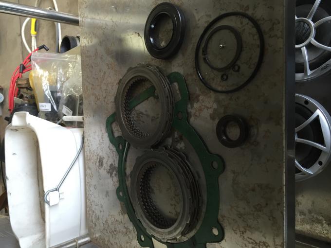

              here is a picture of all the clutches, gaskets and Orings that you need to change. The bigger stack of clutches is the forward set and the smaller stack the reverse set: there the same clutches and all come in the same kit you just put some in the reverse section and some in the forward section.
