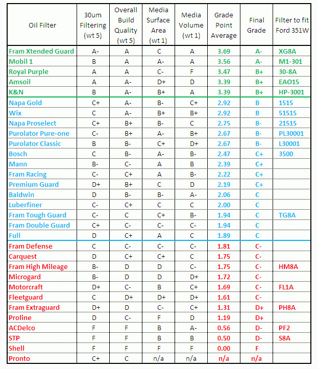

                I agree a multi-weight oil might be worth a try, however use the proper specification such as 20W-50. Valvoline VR-1 20W-50 is a good choice. I'd also suggest a new oil filter such as a Mobil1. See the filter chart below (courtesy of CCFan.com). The FL-1A was not highly rated (although many use it).
Name:	Filter Chart.jpg
                    [ATTACH=CONFIG]n495907[/ATTACH]
                    Completely Misconstrued
                    Never said to run Mobil 5-30 I said "LIKE Mobil 5-30 or something", as in it's an example of a multi weight oil. the correct weight range he chooses is dependent on his climate which I don't know enough about to make a specific multi weight recommendation. If he's skiing in a dry suit and its 40F and his boat is using 35F raw water as its cooling source then I would think 5-30 would be fine. Point to be made was to try a multi weight oil which I think we agree on.
                    I never said nautique makes oil recommendations or I least didn't mean to anyway. Insert "forums" after nautique. "These nautique forums" is what I meant but didn't think it was worth another post to correct that typo. Mobil 1 oil is one of the top 3 oils in zinc content I believe as per your CCF oil analysis thread your quoting from with filter recommendations? After all that CCF thread is why I'm choosing to run Mobil 1 in my GT40. Does it have 1400 ppm no but **** 900 is close enough for most people plus Mobil 1 is easily obtainable in almost any auto supply store. There are many oils to choose from if your in top 3 or 4 I would think that's a highly recommended oil? But maybe that would require defining "highly recommended".
                    Try the valvoline VR1 20-50 it should help lower your psi upon warm up as compared to straight 40W if that's what your trying to accomplish.

                      I'd not seen that thread on ccfan before - http://www.correctcraftfan.com/forum....asp?TID=31299 and I don't really want to start a "which oil filter is better" debate as they've been done to death, but it does make some interesting reading. Worth noting that the base data, for a GM 5.7L truck, does only take into account filtering @ 30µm and not flow rate - http://www.gmtruckcentral.com/articl...lterstudy.html
