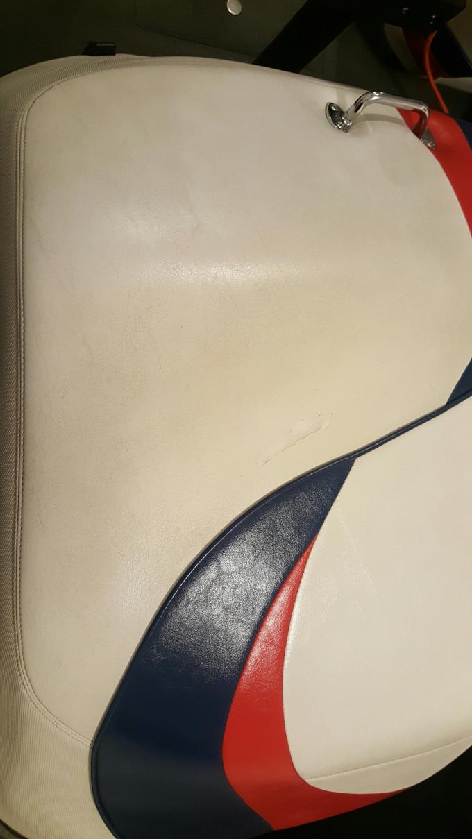

    Looking for some advice on how to fix up this small upholstery peel I have on the engine box. Overall the upholstery in the boat is in great shape considering it is 11 years old and has seen very little prolonged sun exposure, just got this one area on top of the engine cover that has kinda peeled back. Looking for opinions on how to go about fixing this, ie whether a local upholstery shop can repair this or whether I should be ordering a new skin and going that route. Either way I'm looking to maintain the same style and quality of the upholstery. I'm pretty handy mechanically but have never done upholstery work myself so I would likely not do this myself, the question is really what the scope of this fix will be. I also plan on getting this fixed over winter and would have no problem removing the engine box to take it to a local shop.
    Here's a pic and you can see the peel that's happening just above the blue line that runs through the middle of the cover.

      Yeah been reading about Christines and have checked out the site, the skins they offer look great. What I'm not sure about is whether I need to go for a total new skin or whether this can be repaired some other way.

        Not sure if the local shops around Ottawa have the expertise to fix this or not, but it seems like a relatively minor problem. It really depends on how big of a problem this is for you and how much you're willing to spend fixing it. I've ordered from Christine's great service.

          OK, an 11-year-old boat so here's where you are: ALL of the vinyl on the boat is aged. There's no stopping it. The sun will eventually get to it and the vinyl will get brittle. Once it does, it starts to crack and you know where this is going...
          If you replace the skin on the engine cover alone, you'll be replacing other skins soon. They'll all start to go. It's a waste of time to do them one at a time. Dye lots may make some skins come out a different shade if you don't do them all at once.
          Moral of the story: If you're going to keep the boat, do all of them at once. It isn't cheap, but it'll make your boat look great. I bet your carpet is worn too...

                  I ended up taking the engine cover to a local upholstery shop in Ottawa who had marine experience. They did a repair by replacing the white and blue pieces with new material. All considered I am happy with the work, although they didn't exactly match the Nautique stitching, not that anyone would notice but I'm a stickler for maintaining the original! In hindsight I probably should have had him replace all the white on the engine cover and not just the damaged section as now the replaced section is new and the other white areas are faded, however the peel and tear are gone so overall very happy!
