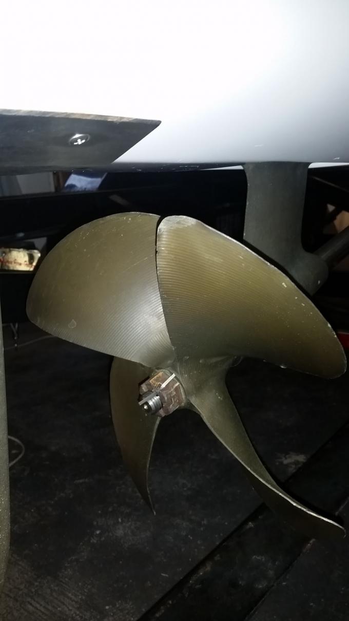

              I just ordered a 1578 for my 03 SANTE since I need a spare prop anyway and am also upgrading the ballast. My stock prop needs to be refinished and the local shop will repair and re pitch it for $165.
              Does anyone have any experience re pitching props?
              Are there any drawbacks?
              Any suggestions on pitch?
              I was going to shoot for 14.75-15" to sort of find the middle ground between 16" and 14.25" (644-1578 respectively)

                My experience with re-pitching was that the prop was never really quite right, it was never really balanced and created a vibration so, I think I only ran it once or twice.
                I too am in the market for a prop and I'm torn between the 1578 and 1236 both have the exact same diameter and pitch, the only diff is cup at .105 and .150. The 1578 is supposed to allow for higher top end.
