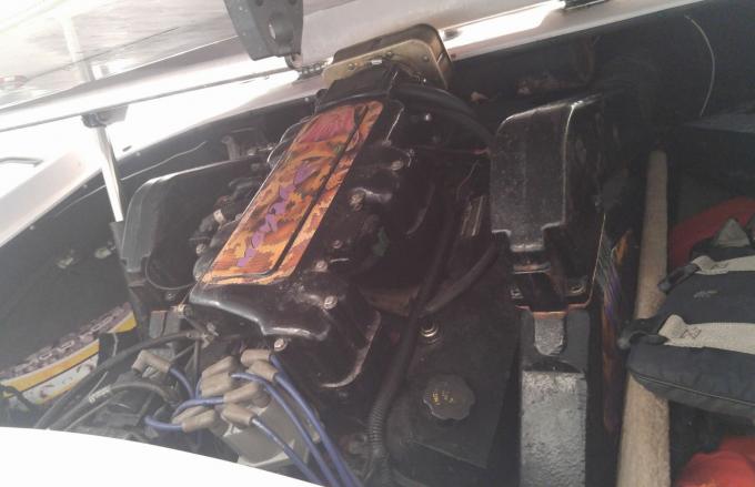

ID:	498817 Hello Shawn, I didn't have any pictures but I took some yesterday.
              I took the boat out 4 times already and it always does the same, sits at 165, when pulling goes up to 175 and when you bring it back to idle, in less than 2 minutes it's back at 165. I still think there's something not allowing all the water to cool down the engine at higher RPM as it should. But I can't find it anywhere.
              Here are the pictures, on one or two you can see the hump on the sundeck they had to add to fit the engine under it. Poor boat needs new upholstery, but I will wait for the winter, I don't want to put new vinyl to have it ruined by the hot Texas sun.Click image for larger version
