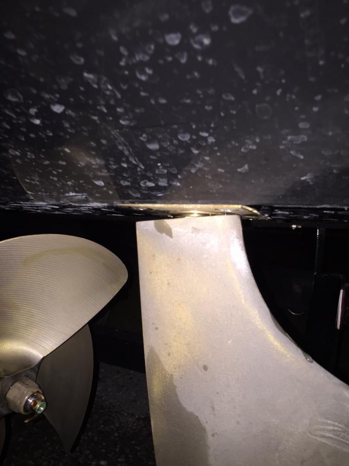

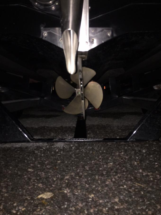

I bent my rudder shaft today running over something in the water and I was curious if bending it back is even possible? Or would it cause other issues with packing and water leaking? It appears to be bent sideways and back a little, causing a major steering issue. How difficult is it to replace the whole rudder and shaft if I have to go that route?

I doubt it can be bent back. I wouldn't try it myself.
Replacing the rudder isn't too hard, except that your boat is a V-drive, so access is, um, limited.I own and operate Silver Cove Marine, which is an inboard boat restoration, service, and sales facility located in Mooresville, North Carolina. We specializes in Nautiques and Correct Crafts, and also provide general service for Nautiques fifteen years old and older.
Honestly steering is a very finite detail. The slightest off true angle or degree can change things tremendously. The rudder job is straight forward. Couple simple bolts. Can be done solo with a jack on bottom of rudder for support or with two people. Mark the old position so you have a reference before you install the new one.
