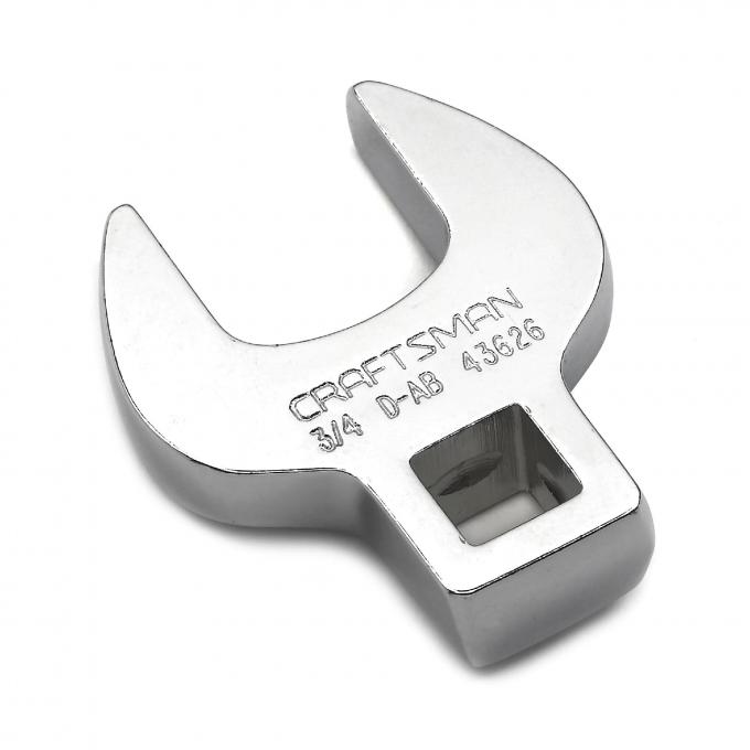

    I have done the fronts, pretty sure they're the same size for the rear. I think they are 1-1/16" or 1-1/8". You will need to remove the bow seat backs to gain access to the nuts. Realize that there are two nuts per stud, one is a "lock" nut. In the front, access is very tight, I would recommend a "crows foot" type of socket wrench...
Name:	crow's foot wrench.jpg

      Thanks for the reply... I tighten it last week, the backs were 1 1/8, I'm not sure what the fronts were, I ended up using a crescent wrench since you can't use a socket because of the speaker wires running through the bolt The crows foot is a good ideal I didn't think of that, I'll try that next time. Thanks again
